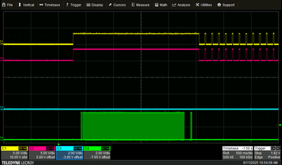

Furthermore, I'm using test point on PCB to monitor the activation of the USB interfaces (CDC and MSC) and use pins to track read write operations on the MSC interface.
The patterns look very similar for IT and DMA driven communication.
IT driven:
DMA driven:
In case of the IT driven approach, the reading activity completely stops once Windows has mounted the drive. In case of the DMA, the access continues indefinitely:
So, after a few days of searching, I was wondering if anyone can spot an issue with this setup or if there is any errata which I missed regarding the UsbX / SDMMC / DMA on the STM32H7.

DZimm.9
I stripped down and migrated my main application to the NUCLEO-H753ZI to provide a minimal firmware example. The code is available on github: https://github.com/NoyzZimmi/STM32H7_MSC_CDC
The issue is reproducible with the NUCLEO, meaning that as soon as I add the MSC to the project / composite class, the USB device fails to enumerate and the SD card isn't mounted properly.
Yellow / red: Activate / Deactivate signals of CDC and MSC
Green: Read activity of MSC read function:

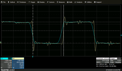

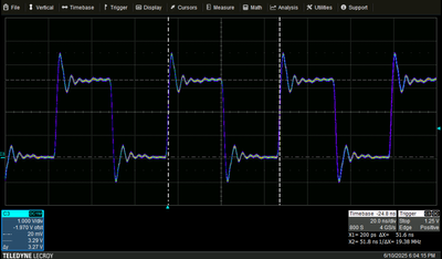

Furthermore, I checked signal integrity and timings of the SD card interface and everything seems to be in order:
SDMMC clock is configure to 192Mhz (PLL1Q from 4MHz) and with the CLKDIV of 5 it results in a 19.3MHz CLK:
Overshoots can be reduced by GPIO speed from "Very high" to "High" / "medium", but it should already be fine for all three speeds. SDMMC CMD gpio speed - very high and low speeds:

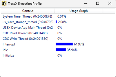

I enabled TraceX for more indepth debugging. It seems that shortly before the USB gets deactivated, the MCU hangs twice in an Interrupt calling ux_trace_device_stack_clear_feature function:DZimm9_1-1749656484370.png
Execution profile confirms this:
And stack usage seems to be fine as well:
Best regards
Daniel

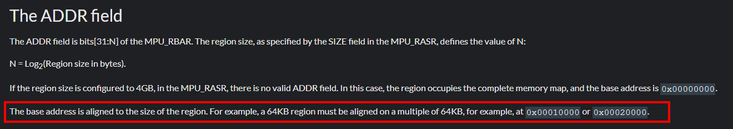

DZimm.9
Hi @FBL / @AScha.3
For a future reference, after digging for a very long time, I finally found the issue causing the SDMMC DMA to fail silently and corrupting the SD card. And of course it was a MPU configuration / cache consistency problem :(
In the first post I provided the USBX pool memory region definition at the address 0x24077000 with length 32K:
/* Specify the memory areas */
MEMORY
  USB_D1 (xrw)			: ORIGIN = 0x24077000, LENGTH = 32K
Configuring the MPU for this address and length does not work properly as according to ARM, the MPU region base address must be aligned to the region size:
DZimm9_0-1756886979195.pnghttps://developer.arm.com/documentation/dui0646/c/Cortex-M7-Peripherals/Optional-Memory-Protection-Unit/MPU-Region-Base-Address-Register
This is a very important bit of information, which I have not found in any STM documentation / application notes... it  might be even wise to add this check to the CubeMX MPU configuration tool to throw a warning when the address is misaligned to the region size.
Best regards
Daniel
FBL
Hi @DZimm.9
An internal ticket 216861 is submitted to dedicated team to improve CubeMX, MPU configuration base address alignment.
