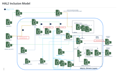

These improvements are very welcome. Especially
* Revision of initialization and configuration
* Improvement of clock configuration and reduce code size
* "Remove Init structure from handle and convert Init structure into configuration one"
* "Remove MspInit and MspDeInit callbacks"
* Changes in the HAL files structure - stm32_hal.h instead of stm32tnxx_hal.h , removal of Ex files
* Factoring "environment" defs out of ...hal_conf.h to stm32_external_env.h
* Replacing the "locks" to OSAL layer with RTOS friendly locks
* Revision of HAL drivers state machines.
* Revision of HAL interrupt handling, esp. "prioritize handling critical interrupts first"
However, some naming looks confusing:
* "Atomic configuration methods" - the word atomic in this context is confusing because it has very specific meaning in C (as in "atomic update state"). Consider  "more granular", "split" etc.
* Same for clocks: here
* Factoring out the LL core.c/h files: the word "core" in this context is confusing. Consider "private", "internal" etc.
* Change values of HAL_Status: IMHO this change is not justified. Following crypto-paranoic "convention" in  general-purpose driver libraries makes no good.

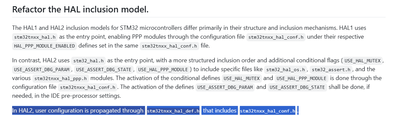

Not clear why stm32xxx_hal_conf.h should be included in hal_def.h rather than directly from stm32_hal.h to make it more visible? But this is a minor point.

here bellow some feedbacks about your comments:
- * "Atomic configuration methods" + Same for clocks: here
Yes what we want here is to bring more granularity for the configuration, it is not about atomic access. we will update the term , "more granular" sounds good.
- Factoring out the LL core.c/h files: the word "core" in this context is confusing: by core we mean a common set of functions to handle the peripherals that allows to have 2 or more HAL drivers on top of it (like usb core + HAL PCD/HCD or sdmmc core + HAl SD/MMC/SDIO)
we think the term core makes sense here in term of architecture. but we will double check with ST architecture team and if required we will update it.
-  Change values of HAL_Status: these are preliminary values to make it better than HAL1 values. we are indeed checking with our security architects to have better values. to help us improving these values could you please provide us with a proposal for these values.
-  stm32xxx_hal_conf.h is included by the hal_def.h only.  There a indeed some issues in the doc : here
we will fix this page: note that this is transparent for the user, all what the application needs is to have the stm32xxx_hal_conf.h at it's side, knowing that the stm32xxx_hal_conf.h is provided as a ready to use template.
BJABR
July 14, 2025
@Pavel A.
regarding the point :
Finally, after double-checking, the document is correct according to the references provided  here (see also below).
I now understand that your point is not about an issue in the document (my mistake, sorry), but rather a proposal to make the hal_conf.h  more visible.
As you mentioned, this is a minor point: the stm32xxx_hal_conf.h file is provided as a ready-to-use template in the package (in . All our examples use this file, and there is no change compared to HAL1 regarding this specific aspect.
From an architectural perspective, we include the stm32xxx_hal_conf.h in the lowest-level header file of the HAL inclusion model, which is stm32tnxx_hal_def.h. This approach ensures that the stm32xxx_hal_conf.h is easily accessible in the inclusion path of all peripherals HAL PPP drivers. And so make all the HAL configuration items defined in stm32xxx_hal_conf.h visible to all the peripherals HAL PPP drivers
