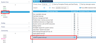

That was the problem. Why would the STcube HAL not take of that? Is that a failure of STcubeMX?

Did you activate the NVIC interrupt in CubeMx for USART2?

SofLit,
No i did not. I see that would be an issue for Ethernet as well.
If I check those 2, will that screw up my existing code?
STcubeMX does handle the assigned input pins for the STM32F107. Makes them outputs.
So it's not a limitation as you didn't activate the NVIC in CubeMx.
To let CubeMx generate the IRQ handler you need to enable it in NVIC menu:
PS:
1 - This is NOT an online support (https://ols.st.com) but a collaborative space.
2 - Please be polite in your reply. Otherwise, it will be reported as inappropriate and you will be permanently blacklisted from my help.
