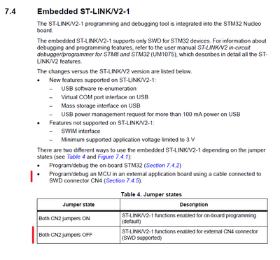

Most of Nucleo64 boards (the ones with "detachable" top part, including Nucleo-F411) may be used for programming off-board MCUs. Read the Nucleo board's manual; you need to remove two jumpers from "ST-LINK" header and connect at least GND, SWDIO and SWCLK available on the built-in ST-Link "SWD" header to the target MCU (NRST connection may also be useful).

Hello @ParkPork and welcome to the ST community,
Yes it's possible to use that onboard ST-LINK to connect to an external MCU. You can refer to the user manual of the board: UM1724 STM32 Nucleo-64 boards (MB1136)
Section 7.4 Embedded ST-LINK/V2-1:
