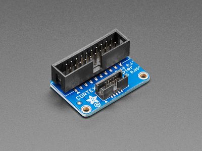

Long story short, given the lack of commercial solutions with the B2B CN2, we went with a COTS solution of this type (the STDC14 cable is already included with the programmer):
https://www.adafruit.com/product/2094
To which I would pair a Hirose HIF3B connector (a female "idc style" connector that accepts wires).
HIF3BA-20D-2.54C(63) + crimp AWG22-26 HIF3-2226SC
Luca
