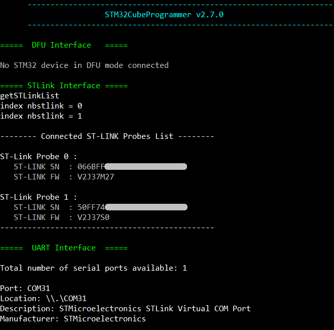

In my case, there are two USB ST-Link in the tester which connected to two MCU: STM32F417 and STM32F091, I need identify the MCU and program flash with different binary/hex file.

There is "list" command in ST-Link utility to list all connected ST-Link probe and serial number.
But the "list" command in STM32_Programmer_CLI can only list serial port.
There are two ST-Link connected to our tester, how can we check if there are multiple ST-Link connected?
Regards
Samuel
ST-LINK_CLI only supports JTAG and SWD, which can be listed using the command line switch -List.
STM32_Programmer_CLI connects via UART, USB, SPI, I2C or CAN. The list command lists at least DFU, SWD and UART connected devices, so maybe the footnote at UM2237, section 3.2.9, should be updated. I've attached an example screenshot of two connected boards with ST-LINK/V2-1 (nbstlink=0...1), one of which offers a virtual COM port, which is also listed:
0693W00000ANEweQAH.pngRegards
/Peter
