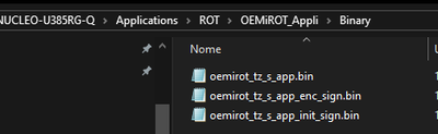

stst9187
small update regarding my previous post.
I am now able to generate the binary files correctly with the single-image configuration.
However, when I run provisioning.bat, I get the following error:
Error: File does not exist: oemirot_tz_app_init_sign.bin
The issue is that inside the Binary directory the generated file has a different name:
oemirot_tz_s_app_init_sign.bin
So it seems that the provisioning script is looking for:
  • oemirot_tz_app_init_sign.bin
while the generated file is:
  • oemirot_tz_s_app_init_sign.bin
Has anyone already encountered this issue with the single-image / Secure-only configuration?
Thank you.
