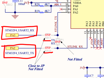

Hi, I am trying to access the Virtual COM port on my STM32F411 VET discovery board but I am not able to find the instructions to do so. I am trying to use serial communication in Simulink where for the STM32F4xx they used the USART2 and VCP com number from device manager. I have two doubts as the user manual is pretty confusing,
1) do i need to make any soldering or changed on the board or change the jumpers to activate the Virtual COM Port.
2) which cable does Vitual com port connect to? the mini USB port or the USB TTL cable, if USB TTL then what pins?

This board? https://www.st.com/en/evaluation-tools/32f411ediscovery.html
This is an older board that doesn't have the VCP functionality with modification, but you can close SB10 and SB11 to get it. Then, it will be available on USART2 (PA2/PA3).
The VCP would be available on the same USB connector as the st-link (CN1).

I don't think so. According to UM and also the schematics even for rev.D, the STLink is V2 (STM32F103C8T6), i.e. not V2-1, i.e. it does not have VCP.

You can't. You need either some external USB-to-UART converter, or some different board (e.g. Nucleo) which does have the newer STLinkV2-1, which supports VCP.

@waclawek.jan I have a USB TTL 232 cable and i tried connecting in to PB6 and PB9, it won’t detect my board, where should i connect the USB TTL cable? PA2 and PA3? In the user manual it does not state anything regarding this.
