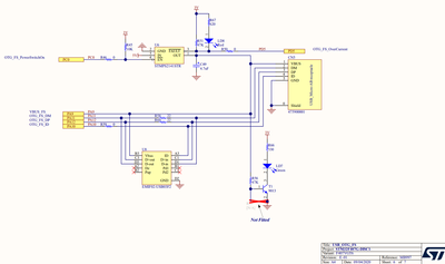

Hello everyone,
I’m working on a project where I am using STM32F407 and I’m trying to establish USB communication between my STM32F407 Discovery board and a PC. I have configured the board for USB_OTG_FS in STM32CubeMX, and I’m trying to use it as a Virtual COM Port (VCP). However, when I connect the board to the PC using the USB_FS port, it’s not being recognized as a COM port or any device at all in the Device Manager.
I want to read the output of the ADC channels using the hercules software
I would really appreciate any suggestions or guidance on:
  1. Getting the board to show up as a VCP in the Device Manager.
  2. Troubleshooting USB enumeration issues.

Hi @Sanyam_07
Weird, it seems a recurring issue on F407 Disco USB.
I think the issue must be linked to the hardware ! Check your solder bridges, resistors, jumpers and connector CN5! Refer to UM1472 precisely section 6.1.3 ST-LINK/V2-A VCP configuration, if you would like to use STlink to echo, you may need flying wires.
Could you specify your laptop's OS.
Maybe as suggested @Pavel A. try this example code.
Best regards,
FBL

No, I am using a data cable and I have tried using it with another board and it is working with it and USB communication is happening

I checked my board and the revision is MB997 E-01
I am still facing the issue where the USB device is not recognized (or gives a malfunctioned error) when I connect it to my PC using the USB OTG FS port.
Here’s what I have tried so far:
  • Used a data-capable USB cable and confirmed connection to the correct port.
  • Selected the CDC class in the USB_DEVICE middleware.
  • Installed the latest STM32 VCP drivers on my PC.
  • Tried on different USB ports and cables.
waclawek.jan
When in bootloader mode (e.g. through BOOT0/BOOT1 pins), does it show up in PC as DFU device?
