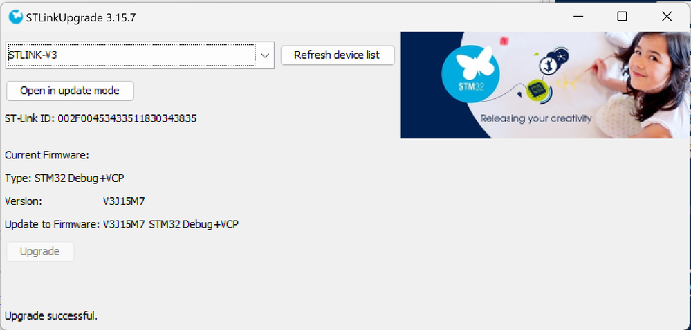

Hi @cersoy ,
Try to perform an STLink upgrade from STM32CubeProgrammer.

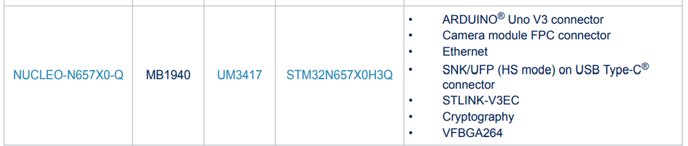

‎2024-12-25 6:15 AM - edited ‎2024-12-25 6:17 AM
Thank you Amel for your prompt response. On page 6 of the document you pointed out, there is a link to the user manual of this specific board:
link to UM3417 does not work.
I upgraded the STlink from the STprogrammer per your recommendation. Below are the snippets:
But still no success accessing the board:
Are there any diagnostics I can collect to troubleshoot the problem. Thanks again for your help.
