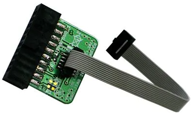

How does one connect the STLink debug port to an older target with 0.025 square posts on 2.54 mm ptch for the debug connections?  As best I can tell, the supplied cables only support 1.27 mm pitch,

I finally got around to using my STLINK-V3PWR or trying. The issue is lack of thought on STM side, one simple adapter like all those ARM adapters but with a 10 pin 1.27mm pitch connector instead of the 2.0mm pitch they have. I purchased the V3PWR since it has a type C connector instead of the micro USB connector and all the power stuff my standalone power board does but with a case. I think I'll have to make a cable, after hunting for several hours I see no solutions. I had one of these https://bit.ly/4g6lPst laying around, with some soldering and crimping it's a start. A real solution would be a bundle like this https://bit.ly/3D9dA0l with a 1.27mm pitch 10 pin instead of the 2mm pitch 10 pin connector.

Just a simple pinout adaptor.
eg, something like this will get you from 1.27mm to 0.1" (2.54mm):
https://www.mouser.co.uk/ProductDetail/Aries-Electronics/LCQT-MSOP10

I would use something like the above to break out the 1.27mm connection to more convenient 0.1", then wire from that to a mating header for your board(s)

Maybe something like these?
https://www.mouser.co.uk/ProductDetail/Olimex-Ltd/ARM-JTAG-20-10
https://www.mouser.co.uk/ProductDetail/Segger-Microcontroller/80602
https://uk.rs-online.com/web/p/development-tool-accessories/1311329
They cite J-Link, but the 20-pin header is pretty standard?
The first and last item on the list may be what will work.  (The links are dead here in the US.)
