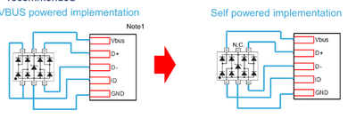

I am having USB Disconnect Issue with my custom board based on STM32F303 Device, configured as USB HID in Firmware with Full speed. Schematics attached here with.
It is Self-Powered board and no VBUS Detection implemented, Currently.

If the USB device is self-poweredVBUS sensing is mandatory. It is recommended to add a simple VBUS detection circuit (e.g., voltage divider or comparator) to sense 5 V from USB host. Detect VBUS presence in your firmware before enabling USB peripheral and Handle USB detach/attach events properly.

3. For Schematic, ST USB training says to connect VBUS to I/O line of USLC6-4S ESD Chip , Instead connecting it to its VBUS pin.
