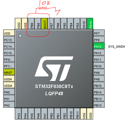

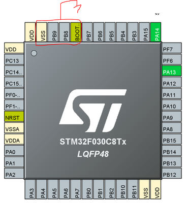

Hi everyone,
Is that not connecting BOOT0 to GND a problem? I forgot to connect it. İs it fine to be floating?
Thank you in advance.

    Peter BENSCH
    January 23, 2024
    If you are not using PB8 and PB9 in the project, you can connect them together with BOOT0 to VSS i.e. GND. However, to be on the safe side, check that PB8 and PB9 are set as inputs in the program (analogue or digital) so that an output does not inadvertently try to drive VSS to VDD level.
    Good luck!
    /Peter
    volkan_Author
    January 23, 2024
    Thank you Peter for the reply. I will define PB8 and PB9 as GPIO input in software. One last question. Is it better option to short  PB8, PB9 and BOOT0 pins and connecting them using single 10k ohm pull down resistor to ground or using pull down will not make any difference?
    Tesla DeLorean
    Guru
    January 23, 2024
    What happens? Often indeterminate operation, especially if the supply rises slowly. Can lead to the ROM code being run rather than user code in FLASH. In the field this is generally undesirable.
    I doesn't have to be directly connected to Ground, better to use a pull down, then a test fixture can be used to change the level in production programming or test situations.
