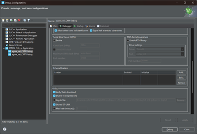

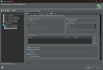

I'm trying to start a project to test a new board Nucleo-H755ZI-Q, but i don't now how dual nucleo works and if is a board problem, code problem or a debug config problem.
Follow some ST docs tutorial or Youtube tutorial give the same error: The CM7 and CM4 debug open, but if i click on run debug, the project debug close and cube IDE back to the code editor.

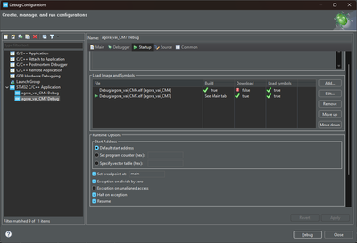

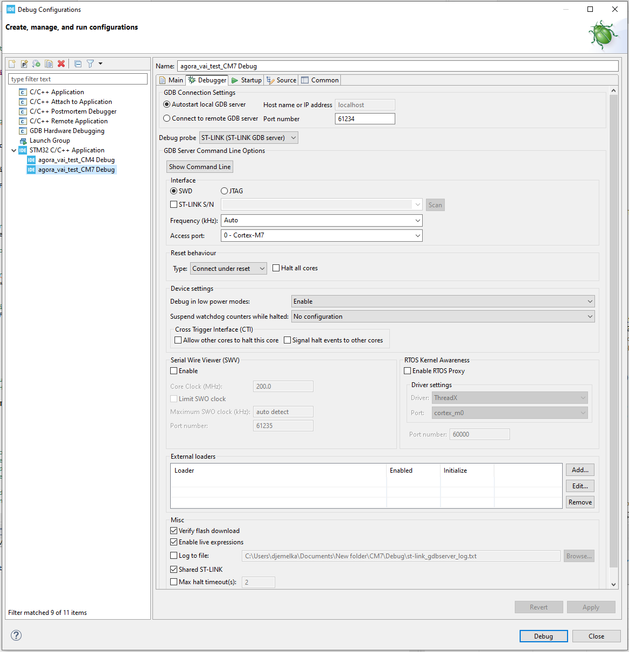

The Debugger CM7 config:
CM7 Debug page1
CM7 Debug page2

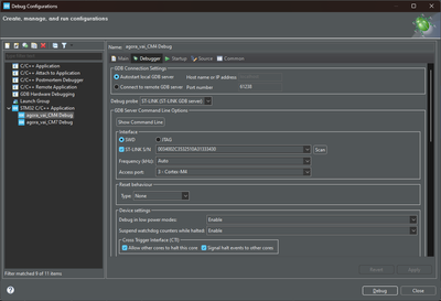

The Debugger CM4 config:
CM4 Debugger page1
CM4 Debugger page2

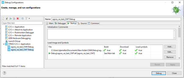

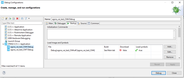

Startup config:
CM7 Startup
CM4 Startup

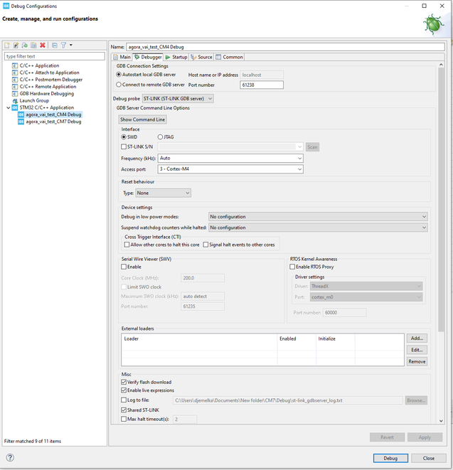

Hello @victorsj ,
Could you please try to uncheck the ST-LINK S/N in the Debugger configuration:
Please make sure in "CM7 startup" that the "Download" of "Debug\agora_vai_test_CM4.elf" is "true" as shown in the below figure.
Please make sure in "CM4 startup" that the "Download" of "Debug\agora_vai_test_CM4.elf" is "false" as shown in the below figure.
I tested your project using Nucleo-H755ZI-Q and STM32CubeIDE1.14.1 and it works correctly.
