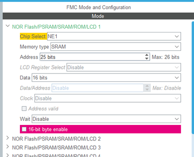

I'm kind of newbie in the STM32 world, I'm more used with another brand of 32bits microcontroller that also have a "parrallel port" for interfacing external ram device.
My concern is about the FMC on the STM32H7.
I want to read/write a 16bits device.
Currently I'm using this configuration (almost the default one) :
My code for testing a write operation :

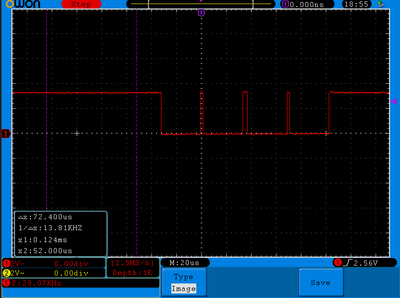

I can't see any problem in the code but when I check signals with an oscilloscope, I can see that the CPU is issuing 4 consecutive write operation :
A0 / A1 are also increasing as if the CPU is writing to 4 different places.
How can it be possible.
I have seen in the datasheet that when AXI bus and external bus is different size, it can occurs. But in that case how to perform a correct 16 bit operation ??

Thanks for your answer, but currently, caching is disable for this region :
How do you know those are *write* operations? Which signal do you display there?
Do you have that area set as Device or as Memory in MPU?
Alex_JAuthor
June 17, 2025
I'm sorry that I forgot to mention that the signal shown is the WE send from the STM32 to the device.

Either I don't know where to search for this option, either it did not exist xD :
Edit :
I also try to deactivate the MPU without success, I still have 4 write cycle.
