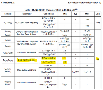

I have a STM32H75x design and suffer from read errors in DDR timing, no matter if run at 50MHz or slower.
It seems that the data hold time of 1ns the H7 is violated. The data output hold time of the SPI NOR MX25L12845 flash is 1ns, which seems to be too short for H7. Due to the fact, that the clock edge takes also ca. 0.5-1ns, the timing should be safe in my opinion. Nevertheless, a read failure arises if the drive strength of the flash is lower than 45Ohm and GPIO pin speed is higher than MEDIUM.
The H7 evaluation boards are equipped with Micron flash with 1.5ns and it seems that this value is fine for H7.
Therefore I doubt the data input hold time of 1ns@3.3V in table 181:
In my opion, this value should be longer than 1ns. Any user experience?

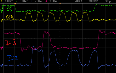

If the MX25 flash driver strength is kept to default 30Ohm, the polling is successful and timing looks like this:
Note the strange timing of the H7 in the first 2 clocks of the command phase.

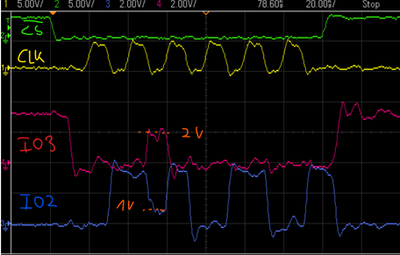

If set to 15Ohm (highest driver strength), the timing looks like this:
Note the strange behaviour of IO3 and IO2 in clock period 2.

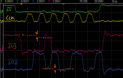

This does to appear on MX66 at 15 Ohm setting, too, but less effect:
At higher drive strength, the signals on IO2/3 are clamped. I cannot find this effect on IO0/1. Maybe this is a result of the special functions WP# / RESET# of pins IO2/3?
