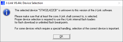

Hello, I tried STM32CubeIDE v 1.0.0 and 1.02 but I think the somethink important doesn't work with a STM32L422CB and maybe with more new MCU. It's old version of J-Link. I can not set new or oldest version J-link in debug configuration. And also ST-link utility can not work with these MCU probably for same reason. It is really stresful0690X00000AAA9IQAX.png

Sounds not possible Thanks UI but maybe updating binaries shipped with tool … ? For sure doing such by your own maybe at risk and pretty sure STM would not recommend … but why not have a try … See <STM32CubeIDE install path>\plugins\com.st.stm32cube.ide.mcu.externaltools.jlink<some id>\tools\bin

I using official J-Link Base from Segger. I could use Segger IDE. (Using new tools from Segger and i think it works, but this solution is not for me, because I can not use for comercial…)
It's long time ago, when i Itried. If i remember I tried ST-link v2, but only I could only erase flash through STlink utilty. ST-link with J-link firmware i can not use
because it's limited. (Debugging on custom hardware is not supported and not allowed)
I think the STML422 was introduced one year ago, it is not so new.
I know the segger has a new version of their tools, but I can not set these tools in IDE.
Thanks. I will try this.
