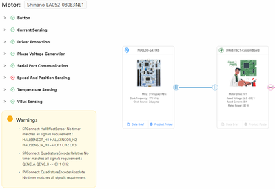

Hello @prathmeshpatil06,
Using the attached JSON file with MCSDK 6.4.2 and the NUCLEO-G431RB board, Hall and encoder warnings appear.
"Conflict detected for pin(s): PC0" which is shared between W current sensing and temperature sensing. The conflict is resolved by disabling the temperature measurement feature.
Project generation for FOC and STO-PLL speed sensing is possible.
If you agree with the answer, please accept it by clicking on 'Accept as solution'.

prathmeshpatil06
please, look i added screenshot. I am getting different errors.
