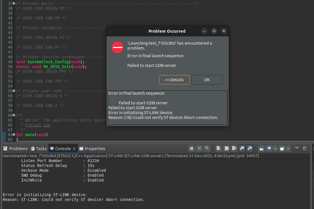

I was working on STM32F103C8T6 Bluepill board. I was using this board with ST-LinkV2 to connect with CubeIDE. When i tried to flash a sample LED blink program via CubeIDE, it gave an error saying 'Target not found'. But at the same time i was able to connect this board via cube programmer using same ST-Link and write sample LED code into the board.

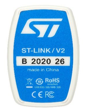

How to recognize a genuine ST-LINK/V2 versus a cloned one. TL;DR: if it looks like a USB memory stick, it's a clone.
Please show the full error message, and log.
It is common that CubeIDE will refuse to work with clone chips & ST-Links; CubeProgrammer may be more forgiving.
What versions of IDE & Programmer are you using, and on what Host?

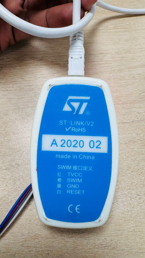

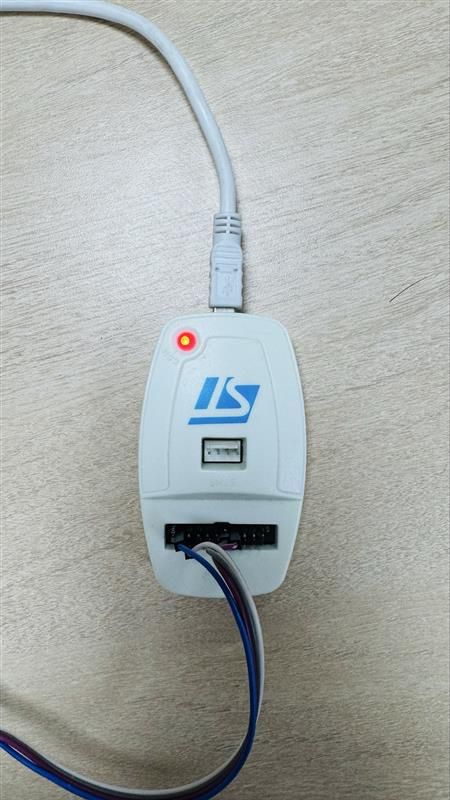

I am using genuine ST-Link(photo attached).

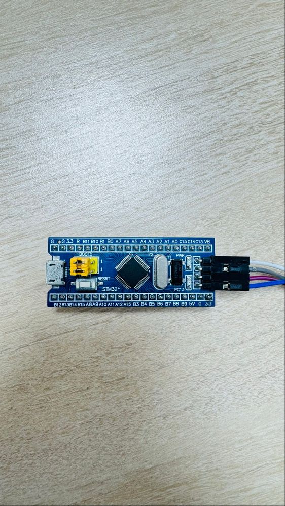

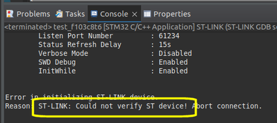

Error message from CubeIDE and photo of Bluepill board attached.
I am using CubeIDE Version: 2.0.0 and CubeMX Version 6.16.1 on Linux 22.04.
product I am using : https://robu.in/product/stm32f103c8t6-minimum-system-board-microcomputer-stm32-arm-core-board/Image.jpegImage (1).jpegImage (2).jpegImage (3).jpegissue facing while trying to debug - GDB issueissue facing while trying to debug - GDB issue

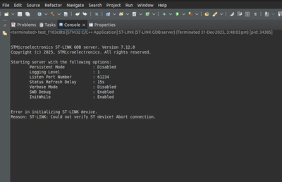

I am also facing a GBD error while trying to debug
Your photo does not match the How to recognize a genuine ST-LINK/V2 versus a cloned one article:
I think that is to be expected with a fake STM32 and/or clone ST-Link.
Again, I would strongly recommend that you at least start with a genuine ST board,  so that you can gain familiarity with the product & tools using known-good hardware - without having to worry about all the extra unknowns with fakes/clones.

Also, "3. show good pic of F103 on bluepill board" means a good closeup of the MCU chip so that we can see exactly what's written on it.

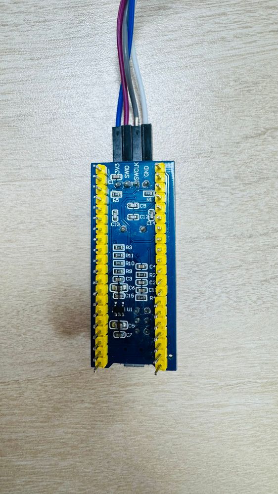

MGogr.1
Why do I feel your ST-Link connections are wrong?!
Could you please verify that once.
I am using genuine ST-Link (photo attached).
@kiranraj_k_r  Confirmed here (by @mƎALLEm) that it's not genuine.
