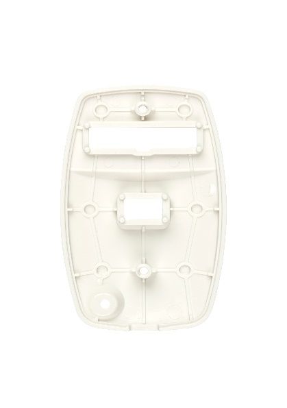

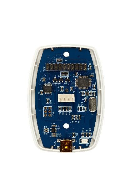

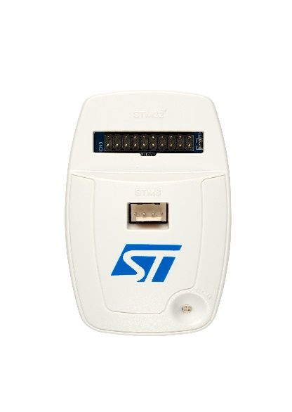

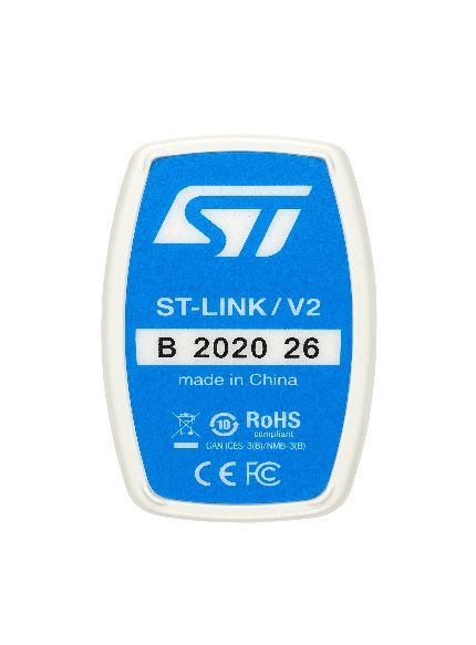

How to recognize a genuine ST-Link/V2
Should a ST-Link/V2 clone properly work with any ST tool or FW?
ST resources are dedicated to support genuine ST-Link products. We are not committed to ensure that clones are properly working with the firmware that we are delivering.

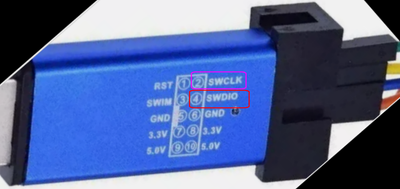

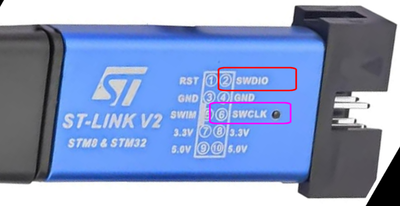

Note that anything looking like this is a fake/clone - even if it does have an "ST" logo on it:
There are many of these fakes/clones which all look identical, but they do not have consistent pinouts - the pinouts can be different, even when bought from the same place!

The clones also don't break out (without manual modding) the SWO pin needed for the "Serial Wire Viewer" (SWV) functionality in CubeIDE, which is very very useful while developing.

And RST is SWIM reset, not SWD reset signal. Moreover there are clones around which have totally weird pull-up/pull-downs on SWDIO and/or SWCLK. Causes communication to target to cease sporadically:
https://www.mikrocontroller.net/topic/515218
Probably the manufacturer just took a reel of resistors without knowing anything about the functionality of the circuit.
