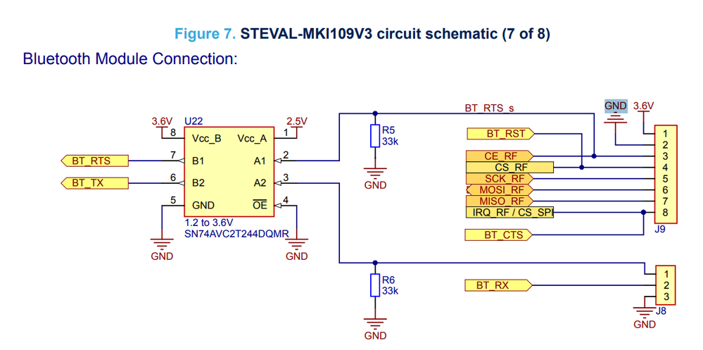

We tried using an HC-05 Bluetooth UART module, connecting it to BT_TX and BT_RX (J9 connector), but it did not work, so the default MKI109V3 firmware support UART input/output on the BT_TX / BT_RX pins ?
  • Can we connect a standard Bluetooth SPP module (HC-05 or similar) to BT_TX / BT_RX and send the same ASCII commands (*SETDB208V1, etc.) wirelessly?
  • Or is USB the only supported communication interface in the default firmware for command parsing and data streaming?

Not only was the STEVAL-MKI115V1 discontinued a long time ago, but also the STEVAL-MKI109V3, but for the latter there is a replacement, the STEVAL-MKI109D, on whose DIL24 socket the same sensors can be plugged in.
It should be noted that the BT module SPBT2532C2.AT was used on the STEVAL-MKI115V1, which was also discontinued many years ago. However, it was not controlled via RX and TX (software handshake), but via CTS/RTS (hardware handshake). Therefore you would have to simulate the hardware handshake using the CTS/RTS lines.
Hope that helps?

Thank you for the explanation. I tried to work based on the solution you described, but unfortunately it is not working for me. I would like to better understand how the RTS/CTS hardware handshaking works in this case.
Here is what I have done so far:
  • I am using a USB to UART TTL converter (FT232RL, 5V / 3.3V)
  • I connected it to STEVAL-MKI109V3 using the following signals:
    • TX
    • RX
    • RTS
    • CTS
    • GND
  • On the PC side, I am using a serial terminal (for example Docklight) and I enabled the RTS/CTS hardware handshaking option.
  • However, I do not see any data communication at all.
  • I also tried providing an external 5V power supply on the J4 connector, and then repeated the same procedure, but the result is the same — still no communication.
Could you please explain how RTS/CTS handshaking is supposed to work on this board?
Any guidance, signal description, or timing requirements would be very helpful.
