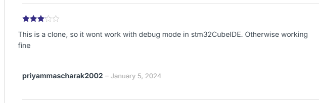

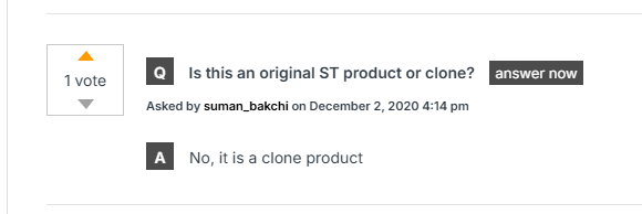

@AScha.3 wrote:
so from link to robu ....  read the comments, before buy (next time.) :
Indeed:

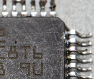

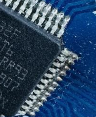

1. photo of the chip on the board is attached.

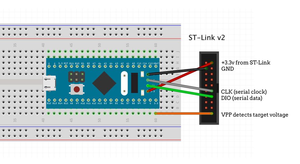

4. i have attached the connection used for board & st linkImage (6).jpegImage (4).jpeg
1. looks like a chip, i have also one; mine is a CKS32F103 ;
just from pic : case corners more round and surface more grainy than real STM:
yours:
CKS:
STM:
But as all chips packed in different fabs today, this just an indication, no clear indication.

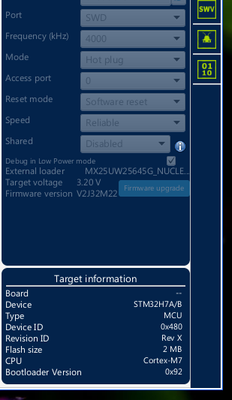

4. connection looks ok; just show, whats CubeProgrammer telling on connect.
like this:
