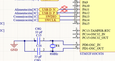

- When no USB is connected, the D+ line is pulled to 3v3, but when connecting the USB it goes down to 2.8 with 0.5v being on the resistor.
- Checked continuity from USB header to A11 and A12 pins (when unpowered)

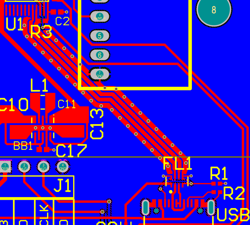

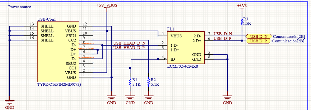

Here are the schematics for that part of the board:
And the layout:

Check the wiring of USB-C connector. The common ones have alternating D+ D- D+ D- pins. On your PCB the wiring is D+ D+ D- D-  - looks strange to me.

Yep, you were right.... thank you so much, Now I have to think how to solve it.
My layout was D- D+ D+ D- and rechecking the datasheet it should be D- D+ D- D+.
