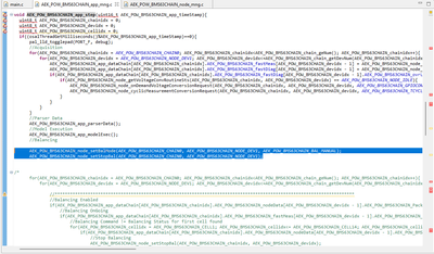

I followed your instruction that use new driver on BMS (BMS_CHAIN). When I run the demo SPC58EC - AEK_POW_BMS63EN_SOC_Est_SingleAccess_CHAIN application for discovery, everything works perfectly. Then, In the function AEK_POW_BMS63CHAIN_app_step, I uncomment all the code of Balancing and replace them with 2 lines of code:
AEK_POW_BMS63CHAIN_node_setBalMode(AEK_POW_BMS63CHAIN_CHAIN0, AEK_POW_BMS63CHAIN_NODE_DEV1, AEK_POW_BMS63CHAIN_BAL_MANUAL);
AEK_POW_BMS63CHAIN_node_setStopBal(AEK_POW_BMS63CHAIN_CHAIN0, AEK_POW_BMS63CHAIN_NODE_DEV1);
However, when I run the program, the balancing is still on. I have several questions could you and experts help me:
1. How and where to use the balancing functions in the demo provided.
2. When enable the balancing, can I have fully permission to change the balancing value of each cells to 0 or 1?. Or these values are automatically turned on by the system?
I also attached the picture of the code and the output for your references.
Thank you for your attention to this matter. I appreciate your assistance in clarifying this detail.

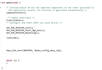

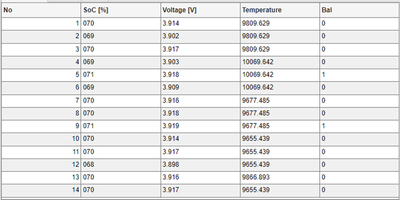

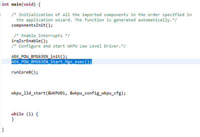

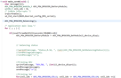

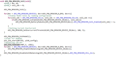

In the main function of "SPC58EC - AEK_POW_BMS63EN_SOC_Estimation_14Cells_GUI application for discovery" example, it has a function "AEK_POW_BMS63EN_init()" that already disabled cell balancing as in the picture:
So, I add the function "AEK_POW_BMS63EN_Start_Mgn_exec()" below  "AEK_POW_BMS63EN_init()" as you said to overrides the expected behavior as in the picture below:
However, the balancing is still enabled on each cell. I also attached the data file (*.xls format) about all the output parameters for you.
Best regards,
Trishuynh.

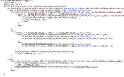

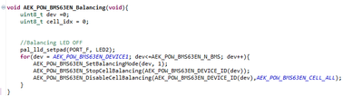

Dear @ATROI@Max VIZZINI@Chronal,
I tested with the old driver by modifying the AEK_POW_BMS63EN_Balancing() function as in the picture below:
After that, I also added this function after the AEK_POW_BMS63EN_Start_Mgn_exec() in the main like this:
Even in the Core0() like this:
However, the balancing still enable based on each cell that has SoC over 3% different from another.
