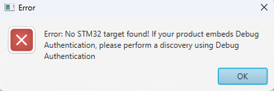

1. I have a Nucleo 64 board.
2. I connected Nucleo64 board to TileBox Pro via SWD and [TX+RX].
3. Tried using STLINK in the STM32 Cube programmer option to program TileBox Pro and i get above error message.
Can you please let me know what is the issue here.

@vlsireddy wrote:
TileBox Pro
Do you mean this: https://www.st.com/en/evaluation-tools/steval-mkboxpro.html - the SensorTile.box Pro ?
Give full details of exactly how you did that.
https://community.st.com/t5/community-guidelines/how-to-write-your-question-to-maximize-your-chances-to-find-a/ta-p/575228
Did you take care to disconnect the onboard Target of the Nucleo board?
