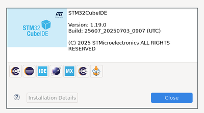

When I try to log into myST from the IDE, it literally does nothing. I click on the button, but no window pops up, nothing happens in the browser, nothing happens in the IDE, no new windows are created.
I don't even get any output on the CLI (if I start the IDE from the CLI).
What is going on here?
This is my version
