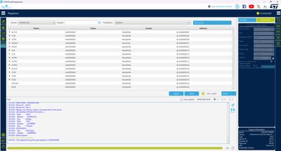

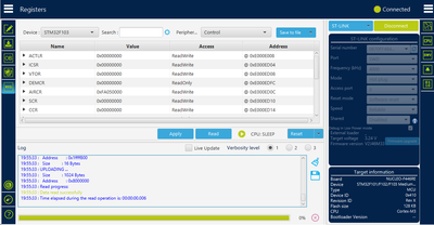

ı use stm32f446re nucleo board as stlink,ı can not connect stmf103 with cubeide ,only with cubeprogrammer in hot plug mode,

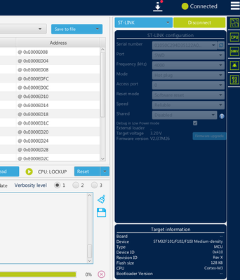

this is the screenshoot ,only see stm in sleep mode , ı try my nucleo board and ı see halted,is there any chance my stm32f103c8t6 is clone
Everything could be a "clone" , but it is very unlikely , as cpu ID (and revision) show same, as on a F103 here:
So connect with :  software reset, nrst not needed;

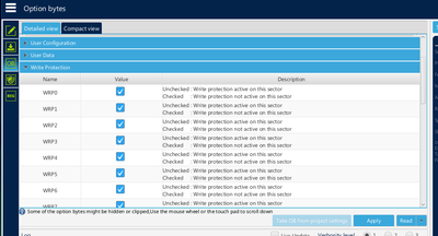

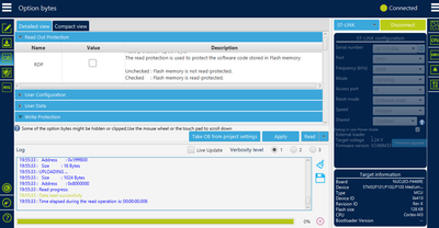

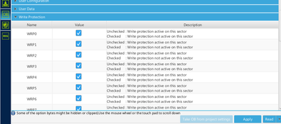

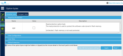

Then look in OptionBytes:   rdp not set:
next see  in OptionBytes: all (!) sectors have write protection OFF (= checked).
down to 31:
Then full/mass erase should work:
Try.

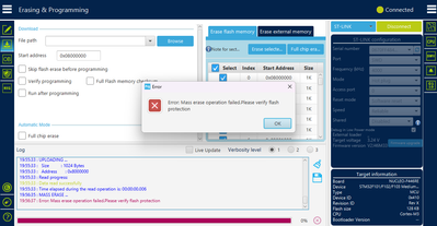

hello again
so when ı checked all option bytes click apply programmer stop working
these are screenshoot when ı try to full erase chip
And you looked at all sectors in OptionBytes  ?
btw

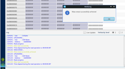

I also got some new chips from distributor, that had some write protected sectors - no full erase possible.
Until you set all to unprotected.
