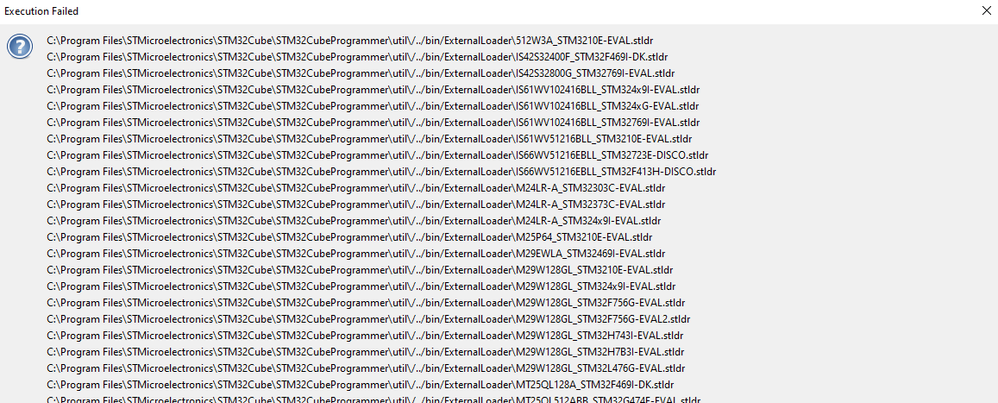

Seeing the same issue as described in original post. Trying to install STM32CubeProgrammer v2.9.0 and already have jre1.8.0_311 installed on PC (no other Java installed, Windows 11). I also have the same error window as screen-grabbed by @AVarg.3​ and posted above--the window popup doesnt allow me to scroll down to get more information on potential system paths being accessed. Any solutions??
Just in case, I also deleted all ST products and tried to go from scratch but that didn't do anything. I have also been running the installation attempts as administrator.
Patrick Chwalek
December 18, 2021
The below image is taken when the "Execution Failed" window pops up.
Patrick Chwalek
December 18, 2021
I found the solution for me which was to get to the bottom of the Execution Failed popup box because there is a selection box that prompts you if you'd like to continue. If you close the Execution Failed window by hitting the "X" in the top right corner, it defaults to "no" and closes the installation session.
What's annoying is that the popup window has no ability to scroll so you have to figure out a way to view the popup window in a way that you can have access to the selection box at the very bottom (ST needs to fix this). You may also be able to select "yes" by clicking Enter when the Execution Failed window appears.
