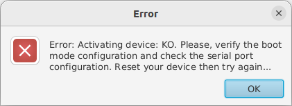

Hi, I am working on making firmware write work using System Bootloader and USART1 interface on NUCLEO-G491RE. I have a code snippet taken from the internet which jumps to the System Bootloader section of the code once the User Button is pressed. I have interfaced a USB to UART converter at PA9, PA10, and GND as suggested in the AN2606.
void BootloaderInit() {
	void (*SysMemBootJump)(void);
	volatile uint32_t addr = 0x1FFF0000;
	HAL_RCC_DeInit();
	SysTick->CTRL = 0;
	SysTick->LOAD = 0;
	SysTick->VAL = 0;
	__HAL_SYSCFG_REMAPMEMORY_SYSTEMFLASH();
	__disable_irq();
	SysMemBootJump = (void (*)(void)) (*((uint32_t*) (addr + 4)));
	__set_MSP(*(uint32_t*) addr);
	SysMemBootJump();

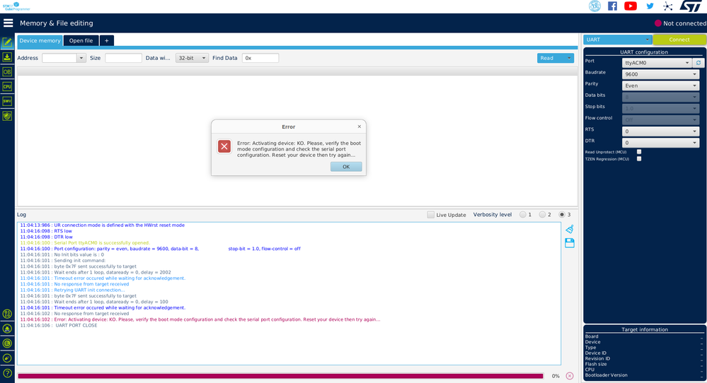

But once the User Button is pressed and tried to connect to the UART interface using STM32CubeProgrammer it shows
_legacyfs_online_stmicro_images_0693W00000bimIOQAY.pngWhy is the firmware upgrade not working?

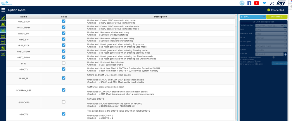

First check hw mode
_legacyfs_online_stmicro_images_0693W00000bimigQAA.pngafter this work try jump into.

Have you valid settings of UART connection? 9600 baudrate and parity even? Power from UART also connected?

Hi, @mm..1​ I have already followed this and changed them using STM32CubeProgrammer using the ST-LINK option. I have opted for the first option on Pattern 15.
Please find those here, correct me if I have missed something.

How does your usb<->uart look like? It works with 5V or 3.3V? MY UART have jumper 3,3<->5V.
When I used STM32CubeProgrammer and UART I choosed 3.3V.

I think about this .... First at all, try enter to boot mode using jumper instead jump from program. We exclude errors in code

ttyACM0 is the only one USB on list?
