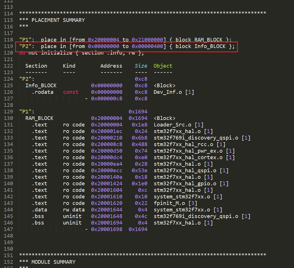

Your ICF File doesn't look ok. You need to consider that the external loader will be moved to the ram and executed from there.
I use this in the ICF:
define symbol __ICFEDIT_region_RAM_start__ = 0x20000004;
define symbol __ICFEDIT_region_RAM_end__ = 0x21000000;define memory mem with size = 4G;
define region RAM_region = mem:[from __ICFEDIT_region_RAM_start__ to __ICFEDIT_region_RAM_end__];define block RAM_BLOCK with fixed order {readonly code, readonly data, readwrite };
define block Info_BLOCK with fixed order { readonly data object Dev_Inf.o};place at start of RAM_region { block RAM_BLOCK };
place in RAM_region { block Info_BLOCK };do not initialize { section .info, readwrite };

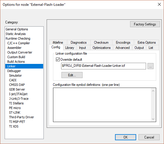

Hi Thanks for your quickly reply. In properties of project I select tab Linker - > I chose override default linker to select my External-Flash-Linker.icf file then I copy all your comment code of linker at this file. But after build project I see in the map file ''P2'': place in [from 0x00000000 to 0x00000400] { block Info_BLOCK } is not correct. What is wrong ?.
