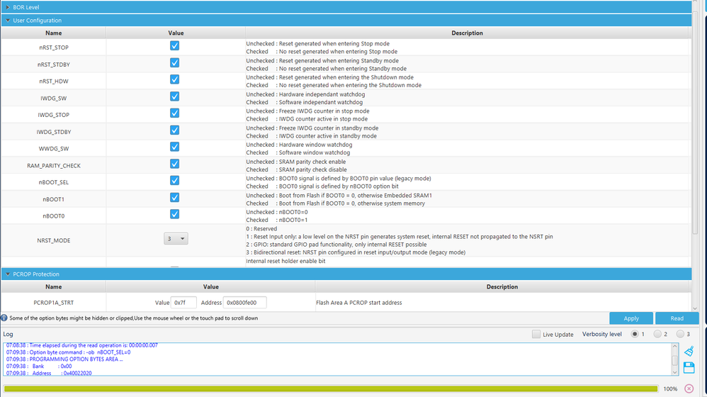

waclawek.jan
> PC: 0x1fff1654
Nice catch.
Humm, maybe the Pattern 6 / Pattern 11 / PEMPTY (in 'G0 called EMPTY, to increase confusion) problem again? That may be exacerbated by the debugger change.
 Quoting from linked post:
Tip: On devices with nSWBOOT0 or nBOOT_SEL option bit (STM32WB, STM32L4, STM32G0) it is possible to force boot from Main flash by using nBOOT0 option bit instead of BOOT0 pin.
This can be achieved by following Option byte configuration
nSWBOOT0 or nBOOT_SEL = 1 (BOOT0 signal is defined by nBOOT0 option bit)
nBOOT0 = 1
KiptonM
Lead

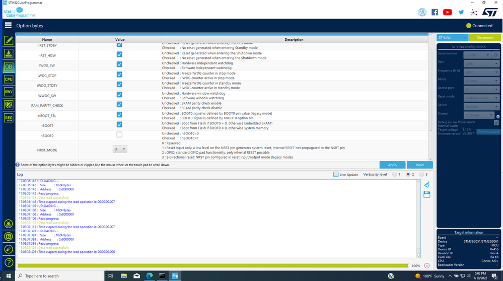

It looks like
nBOOT_SEL was checked which meant BOOT0 signal is defined by the nBOOT0 option bit"
nBOOT1 was checked which meant Boot from Flash if nBOOT0 = 0, otherwise from system memory
nBOOT0 was checked nBOOT0 = 1
This caused it ti boot from system memory.,
I changed nBOOT0 to unchecked where nBOOT0 = 0
So that should have fixed it and cause it to boot from Flash. I am still having the same problem.

Could it be it booted into the system because I am running the debugger?
Piranha
Chief II
That CubeProgrammer description of nBOOT0 and nBOOT1 options is a nonsense. Again a blind trust without checking the real thing - reference manual...
Look at the RM0444 Rev 5, 2.5 Boot configuration, Table 8. Boot modes.
@Houda GHABRI​
KiptonM
Lead
Thanks for the pointer. And yes I should be wary of ST software.
Looking at Table 8 the 4th line is a way to get to Main Flash Memory.
nBOOT_SEL bit needs to be 1
nBOOT0 bit needs to be 1
nBOOT1 bit does not matter
BOOT0 pin does not matter.
I thought that is what I started with before I started changing the fuses!
0693W00000QLd1JQAT.pngIt must not have been, because the PC Changed and the test code works.
