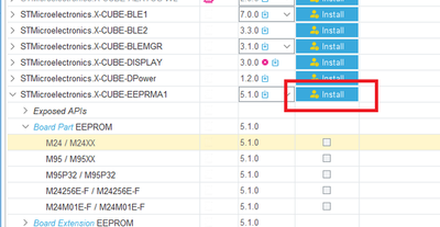

I am in work with a product firmware with STM32G030k8 with additional EEPROM M24C04 I coudlnt ble to instal the driver files .
Is this the righ tway am doing,can any one please address this?I am not able to hightlight or install Thanks.

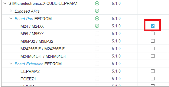

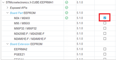

You need to check one of the available drivers:
For example, for M24 / M24XX, check the box on the right and click OK.

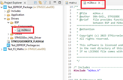

In "Middleware and Software Packs" menu , click on X-Cube-EEPRMA1 and check the box "Board Part EEPROM"
After generating the code, M24XX driver is included in the project.
Attached an example of ioc file.

Hi Thanks  yes but for some reason I am not able to tick (enable )the driver  or install.May I know what is wrong
Sorry, I didn't understand. Did you try the ioc file I provided ?
I'm able to open the EEPROM driver

havent got a solution for this .I couldnt able to download the packs For some reason Iam not able to instal the particular board part.I am using stm32G030k8 MCU

I am trying to install the drivers for M24 EEPROM chip which is interfaced with STM32G030k8 MCU.
As you said I have tried but my issue is I am not able to check that part or if i click install its nothing happening
Do you mean you cannot check that blue box?
Or when you click on Install button nothing happens?
