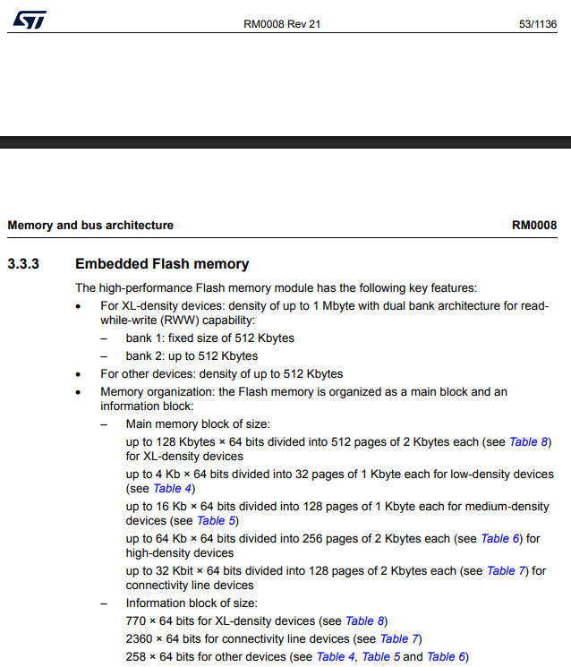

https://www.st.com/resource/en/reference_manual/rm0008-stm32f101xx-stm32f102xx-stm32f103xx-stm32f105xx-and-stm32f107xx-advanced-armbased-32bit-mcus-stmicroelectronics.pdf#page=54
via: https://www.st.com/en/microcontrollers-microprocessors/stm32f103vc.html#documentation

I don't see in that code where you set the location of your emulated EEPROM within the Flash ?
Also, how much of the Flash is used by your code?

You still haven't shown where you set the location of your emulated EEPROM within the Flash.
Are you using the correct EEPROM Emulation library?
You need AN2594 for STM32F1 - not X-CUBE-EEPROM:
https://community.st.com/t5/stm32-mcus-embedded-software/x-cube-eeprom-not-for-stm32f0/m-p/674820#M47836:~:text=STM32F1%20%2D%20see%20AN2594%20instead%3B
