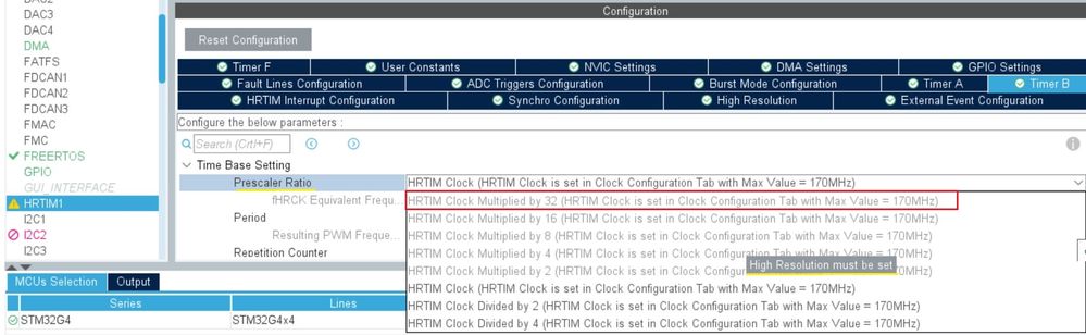

Hi @MOys.1 ,
If I well understand your problem, and backing to your attached .ioc file, you're not able to select HRTIM Clock Multiplied by 32 prescaler ratio through CubeMX:

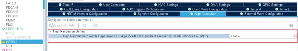

As indicated by the displayed contextual help message when hovering the mouse over HRTIM Clock Multiplied by 32 prescaler ratio, the High Resolution should be enabled

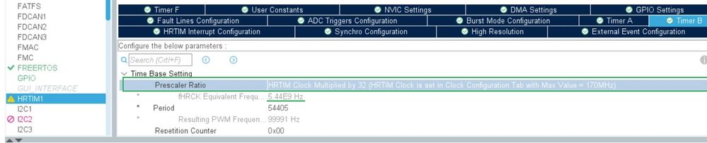

Once High Resolution is enabled, it will be possible HRTIM Clock Multiplied by 32 prescaler ratio through the Timer B window tab:
Those are the steps in order to increase fHRCK to 5.44GHz.

I know that High Resolution must be enabled to select HRTIM Clock Multiplied by 32, but when I selected that for the ADC timer the ADC didn't work properly. I intentionally disabled High Resolution, so I could at least work with the ADC.
