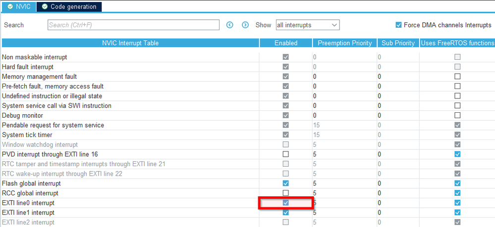

I am trying to configure PJ0 as an external interrupt on an STM32F767.
Enabling the EXTI0 interrupc removes the functions TIM1_UP_TIM10_IRQHandler from the generated code. This results in a DefaultHandler call comming from the timer.
I am activating the interrupt here:
This generates the following code changes:
--- a/03-Implementation/mp12plus/Core/Inc/stm32f7xx_it.h
+++ b/03-Implementation/mp12plus/Core/Inc/stm32f7xx_it.h
@@ -53,13 +53,13 @@ void BusFault_Handler(void);
+void EXTI0_IRQHandler(void);
-void TIM1_UP_TIM10_IRQHandler(void);
And the implementation of TIM1_UP_TIM10_IRQHandler is also removed. Any idea of why there is this behaviour?
Adding the lines manually again makes code work again.
Note: configuring the PJ0 as EXTI0 does not trigger this behaviour, its the activation of the NVIC that actually triggers this function erasure.

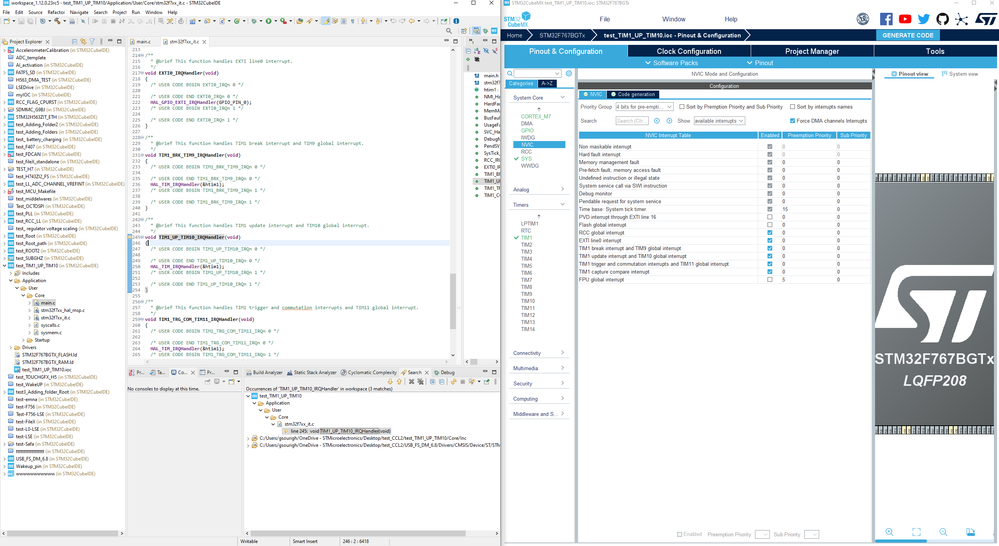

2023-04-18 3:36 AM - edited 2023-11-20 7:55 AM
Hello @Community member
I tried to reproduce the issue using CubeMX6.8.0 and this is what I got please have a look
By checking the generated code , I found both functions "TIM1_UP_TIM10_IRQHandler" and " EXTI0_IRQHandler"
Thx
