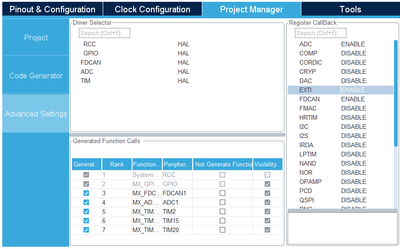

Setup:
  • STM32CubeMX Version v6.14.0
  • SMT32Cube FW_G4 V1.16.0
Problem Description:
When enabling RegisterCallback for EXTI Interrupts, the generated code still calls a predefined interrupt callback  for EXTI interrupts and does not call the registered callback function.

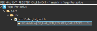

The generated code sets the correct #define value, but the define value is not referenced anywhere in the code.
#define USE_HAL_EXTI_REGISTER_CALLBACKS       1U
Expected: The interrupt calls the registered callback function instead.
How to reproduce:
  • Enable EXTI Register Callback:
  • Set a GPIO to trigger an interrupt:
  • Enable interrupt for the GPIOs EXTI line
  • Generate Code
  • The generated interrupt handler does not call the registered interrupt. Instead, it uses the normal interrupt function just as if RegisterCallback for EXTI is disabled.
