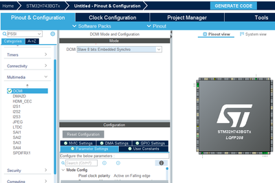

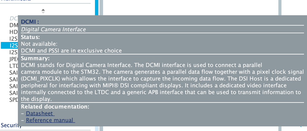

On the data sheet of the STM32H743BGTx it states that DCMI peripheral is available for the STM32H743BGTx.
But on the STM32Cube IDE is says that is not available.
In the following screenshot I have picture the message.
Why DCMI is not available when on the data sheet it states that it is? Is there any other version of the ic that DCMI is available?
Thank you

Hello @Avgerinos ,
Make sure to use the latest release of STM32CubeMX (v 6.12.1).
Please try the new CubeMx version, then keep me informed about your update.
Thanks
Imen
