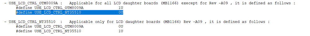

‎2024-07-16 1:58 AM - edited ‎2024-07-16 2:00 AM
update :

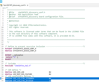

i managed to run the project . i used the folder that was downlaoded automatically when i selected the board the first time in MX. now i have an other problem. the snapshot mode worked perfectly but the capture mode didnt . when i checked the readme file i found this configuration that i need to do since im using a rev09 camera but i couldn't manage to do it . so is there any guide to help me so this adaptation. in which file i can find these lines of code...

Hello @yessine ,
I think you facing another issue which is different from the initial one. For more visibility it recommended to create a specific thread for this new issue.
-->the snapshot mode worked perfectly but the capture mode didnt .
What do you mean by capture mode didn't work. Do you get a noisy screen with DCMI_CaptureMode example?
To make work the DCMI_CaptureMode example with MB1166 Rev-09, it is recommended to use the latest STM32Cube_FW_H7_V1.11.2 version and change the code lines in stm32h747i_discovery_conf.h file under STM32Cube_FW_H7_V1.11.2\Projects\STM32H747I-DISCO\Examples\DCMI\DCMI_CaptureMode\Common\Inc as mentioned in readme

‎2024-07-17 7:19 AM
im glad to say that everything work . problem is solved . capture mode and snapshot and people counting feom fp ai vision folder
for fp vision folder i followed some steps from this link https://wiki.st.com/stm32mcu/wiki/AI:How_to_perform_people_counting_using_FP-AI-VISION1_and_STM32H747XI
it was jut a problem of sime files that i need to paste from 11.2 folder
and for capture mode i just needed to change a line in some config.h file (change nt**** to OU from 1U and and om**** from 1U to OU)
