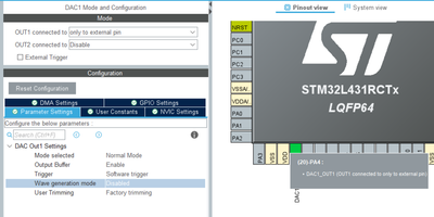

I am use STM32L431RCT6,and my CubeMX config is this:
And my code is:
uint32_t data = 128;
ret = HAL_DAC_SetValue(&hdac1, DAC_CHANNEL_1, DAC_ALIGN_8B_R, data);

And if my Trigger method use None, measure is OK(middle with VCC).
I do not know why.

Read out and check/post content of DAC and relevant GPIO registers.

[BUG] DAC software trigger at STM32L431 have not s... - STMicroelectronics Community
I have learn DAC reg, and I have find CubeMX question. Thank you.
