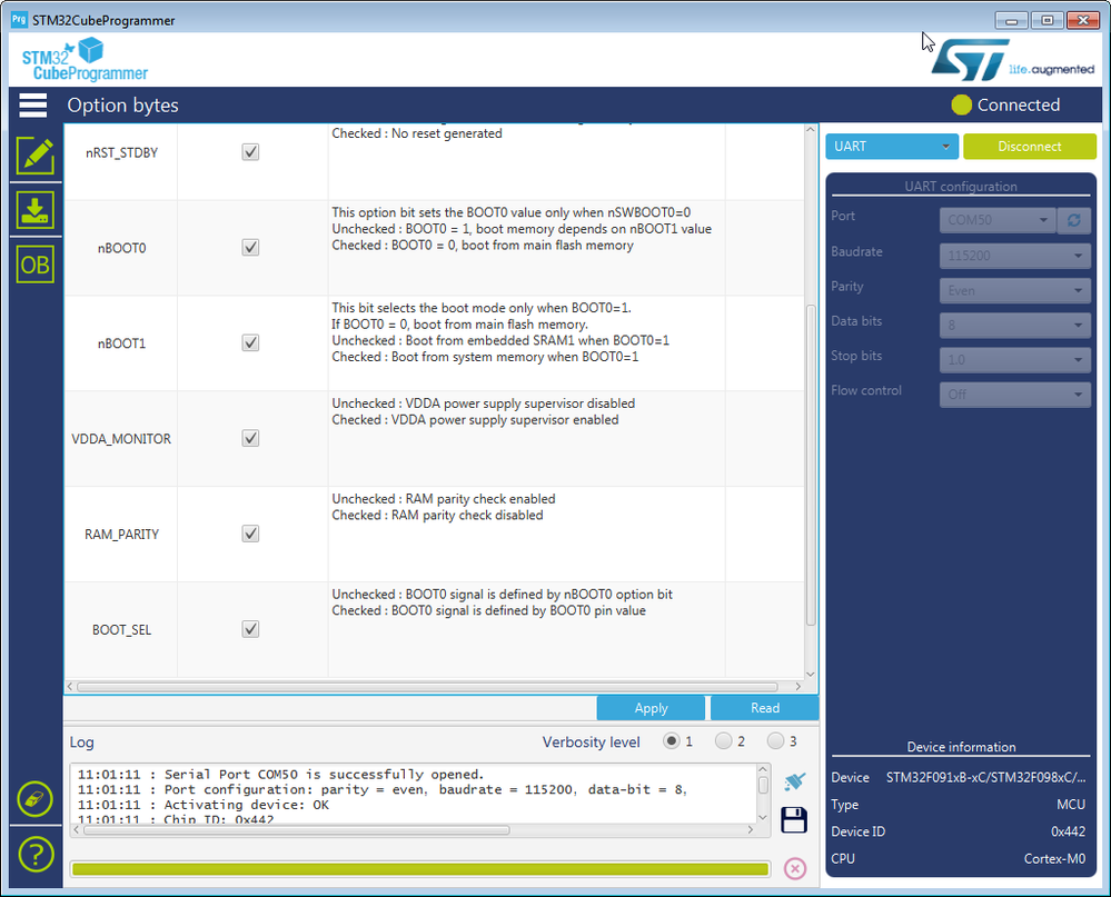

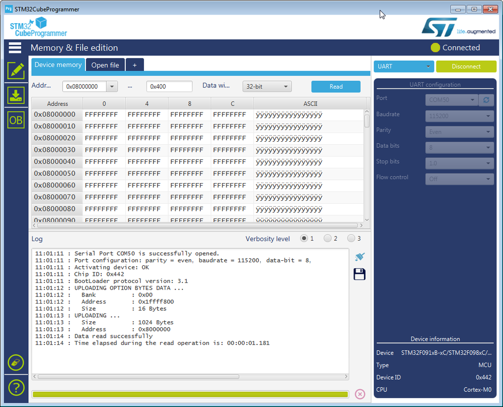

I tried to use STM32F091 with UART connection and STM32CubeProgrammer. I used UART pins PA2 and PA3. I used Nucleo board with integrated USB to UART virtual COM port (VCP). Connection is correct - no problem. See attached screenshots: see there given UART configuration, option bytes configuration (I just set externally BOOT0 pin to VDD), device memory is empty (no code inside). Please check this configuration in your side.

There is no need to program the device with any firmware - the UART is used for direct communication with device through embedded bootloader. So - just set device into boot mode (by setting BOOT0 and BOOT1 pins/option bits) and restart it and then connect to device by UART by CubeProgrammer.

In reference manual RM0091 see table in chapter "2.5 Boot configuration". There are two possible configuration how to enter into boot mode: the mode must be "System memory".
1) BOOT_SEL bit = 1, BOOT0 pin =1 , nBOOT1 bit = 1
2) BOOT_SEL bit = 0, BOOT0 bit =0 , nBOOT1 bit = 1
After option bytes programming please perform power-on reset (power off and on) - to be sure that the new option bytes are loaded.
