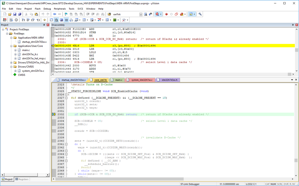

I am currently developing software for STM32H7 processors. For this I use the current development environment from Keil (uvision 37.0.0) and Cubemx 6.4.0.
I created an "empty" project for the Nucleo Board STM32H743ZI with Cubemx. In it I only activated one property:
SystemCore/COREX_M7/CPU DCache : Enabled
When I compile and upload the generated code I have a strange phenomenon: The program doesn't stop at __Main in the startup-code and also not at HAL_Init() in main.c, but it stops in core_cm7.h in the line:
if (SCB->CCR & SCB_CCR_DC_Msk) return;
But I didn't set a breakpoint there!
My question is about this unwanted "stopping effect" during start phase. The example above is the easiest to reproduce and demonstrate the problem. In fact, I'm working on another project, but that's where this effect degenerates. Sometimes I have to press the F5 key 4 times before the program finally gets to main. This is unbearable in the long run. Does anyone know this effect and has a workaround for it?

Using Keil, H7 and Nucleo-H7 boards, and NOT having these issues here.
Would suggest looking more closely at clock and PLL settings, along with VOS settings, and whatever is happening in SystemInit()
Check HSE_VALUE define
These are H743ZI or H743ZI2 boards?
You can uncheck "run to main()" and step in from the beginning.
Do the board examples build and function properly?

Probably not a problem, but you are using an old CMSIS-Core(M) version. At least this old:
https://github.com/ARM-software/CMSIS_5/commit/8ced160cc8362da0fdd794a3e87275b15416b287
> uvision 37.0.0
Why are you inventing version numbers? The current version is v5.37.

@Tesla DeLorean: It is a H743ZI. The board usually shows no problems. Things get weird when the D-cache is activated.
@Thank you for the starting points. That seems to become a complicated thing.
@Piranha: Sorry, I forgot the 5 in the version number (MDK-ARM Essential Version: 5.37.0.0)
Ok, maybe that's asking a bit too much: If you create a new, empty project for the Nucleo H743ZI board and only turn on the D-cache, will only I have the effect?
