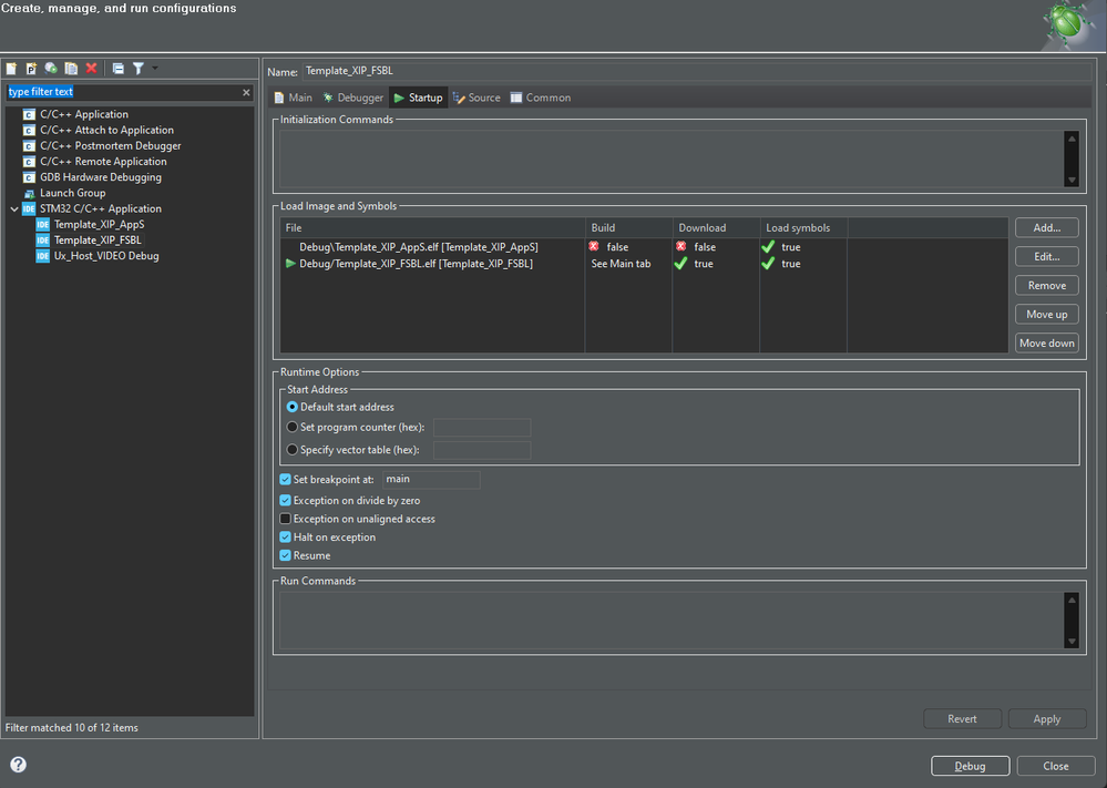

I am trying to debug STM32N6 program loaded in external flash. When I started the debugger in the FSBL project I can put a breakpoint just before it jumps into application inside external flash. It is obvious I wont be able to see the symbols since it is not loaded. So I loaded my application elf file under debug_configuration/Startup/Load Image and Symbols (See attached image). When I start my debugging session, I encounter the following error and was unable to debug even FSBL code.
Board: STM32N6 DK
STM32CubeIDE: 1.17.0
Platform: Window
project: Template_XIP_FSBL (found under Stcube package for N6).

If we load the application symbols during the debugger's start-up sequence, GDB won't be able to resolve those addresses because the external flash isn't memory-mapped at that point (i.e., after a reset). I confirmed this by disabling symbol loading during start-up. Instead, I set a breakpoint just before the FSBL was about to jump to the application. Once the program counter hit that breakpoint, I manually loaded the application symbols using the add-symbol-file command in the Debugger Console. After doing this, I was able to see the source and symbol information when I hit pause.
Now, I need to figure out how to set breakpoints within the application itself. Simply placing breakpoints in the application code doesn't work at this stage.
UPDATE 2: I just need to add source dir and memory region at this point. Once we hit the breakpoint at JumpToApplication() enter following commands in Debugger console.
add-symbol-file "your application.elf location"
set directories "your application source code dir"
// check mem region in gdb
info mem
// if info mem output doesnt contains external flash regions, add those regions
// following address is for STM32N6 XSPI2
mem 0x70000000 0x7fffffff
// if above command gives error delete existing memory regions and add memory regions manually. That should follow linker script
// following command delete region 0
delete mem 0

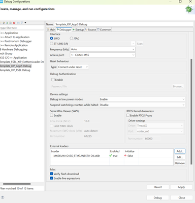

First make sure to add this
Select ST-LINK (OpenOCD) as the [Debug probe] in the debug configuration of the Template_ XIP_FSBL
Also let's try to generate the trusted binary, this could resolve the issue .

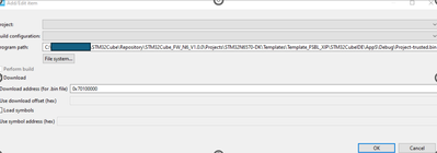

To sign the binary we need to launch this command: STM32_SigningTool_CLI.exe -bin Template_XIP_AppS.bin -nk -of 0x80000000 -t fsbl -o Project-trusted.bin -hv 2.3 -dump Project-trusted.bin
This step could be done also from within the STM32CuebIDE tool using the post build command option as described below.
1-Right Click on Template_XIP_AppS(in Apps), [Properties]>[[C/C++ Build]> [Settings] [Build Steps]
2- Tap on the Post-build steps this command: C:\ST\STM32CubeIDE_1.17.0\STM32CubeIDE\plugins\com.st.stm32cube.ide.mcu.externaltools.cubeprogrammer.win32_2.2.0.202409170845\tools\bin\STM32_SigningTool_CLI.exe -bin Template_XIP_AppS.bin -nk -of 0x80000000 -t fsbl -o Project-trusted.bin -hv 2.3 -dump Project-trusted.bin
3-Click on [Apply], then build the Template_XIP_AppS to generate Project-trusted.bin
after generating the trusted bin go to
select add in order to add Project_trusted.bin and make sure to choose the download address for the Themplate_FSBL_XIP :0x70100000.
Please check Readme under C:\Users\XXXXX\STM32Cube\Repository\STM32Cube_FW_N6_V1.1.1\Projects\STM32N6570-DK\Templates\Template_FSBL_XIP
