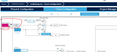

The clock configuration keeps getting an error。

Change the clock source of i2c4
2024-06-19 3:50 AM
@sxiao.1 Well... 0.03277kHz at LSE = 32.77Hz. A bit too little...
2024-06-19 3:56 AM
It changes 32.768k to 0.03277 when Change the clock source of i2c4。I didn't modify it
2024-06-19 5:15 AM - edited 2024-06-19 5:17 AM
So you didn't describe very well the issue from the beginning.
As I understood, in CubeMx, you set LSE clock to 32.768Hz. When you enable I2C4, an issue appears on LSE clock. Is that what you are facing as a problem? please be more specific and clear with your descriptions, what is the H7 part number? is that possible to share the ioc file?
