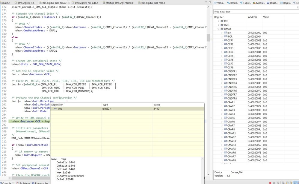

0693W00000FCWneQAH.jpg0693W00000FCWsnQAH.jpg0693W00000FCWsEQAX.jpgBecause my bare metal version of a ADC1+DMA1+DMA1_CHANNEL1+DMAMUX+TIM3 System will not work,
I now try to build such a system using STM32CubeMX/HAL - but with greater problems.

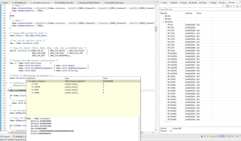

Now writing to hdma->Instance->CCR fails, when I step
into MX_ADC1_Init(),
into HAL_ADC_Init(&hadc1),
into HAL_ADC_MspInit(hadc),
into HAL_DMA_Init(&hdma_adc1)
to the line hdma->Instance->CCR = tmp;
tmp has the value 0x5A0, hdma->Instance->CCR before an after execution of this line the value 0.
Has the DMA1-Clock to be enabled for writing to DMA1->CCR?

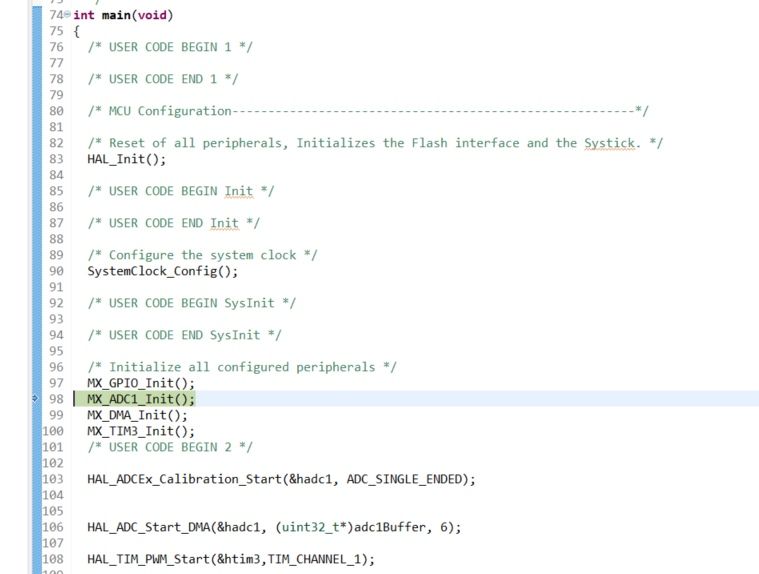

If so, the STM32CubeMX generated siftware will never work, because this Clock will be enabled
inside MX_DMA_Init(), which will be called after MX_ADC1_Init()?

Hello @ULehm.1​ ,
Thanks for your post.
This is a known issue with CubeMX v6.3.0: the MX_DMA_Init() shall be called BEFORE any other peripheral initialization when DMA is used.
 This issue will be fixed in the coming releases of CubeMx (see this post for more details).

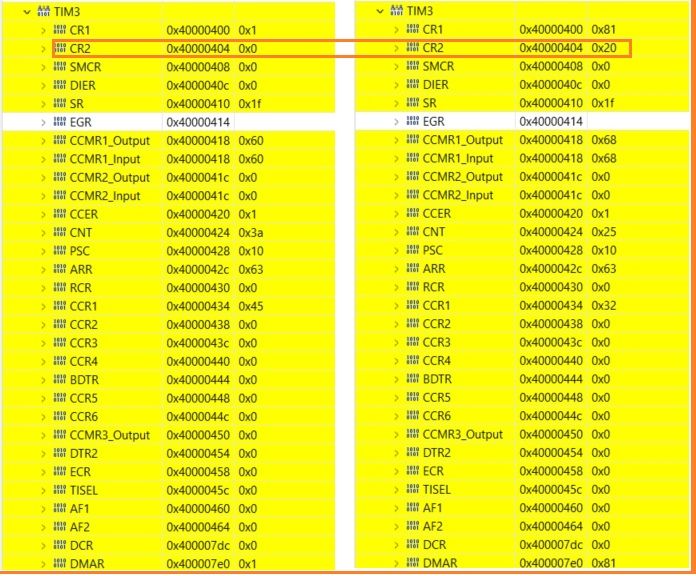

> What benefit you gain from clicking?
Intention was to compare the SFR contents of the bare metal version with the "clicking" version
and throw an eye on the differences - with success!
