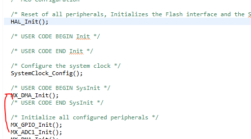

‎2022-12-21 2:20 AM
Is DMA initialiced before the ADC? it should be
It is a known CUBEMX issue.
Also check the buffer sizes you configured, they might not match with your real buffer.
‎2022-12-21 6:10 PM
DMA_InitStructure.DMA_BufferSize = 2;
DMA_InitStructure.DMA_PeripheralInc = DMA_PeripheralInc_Enable;
DMA_InitStructure.DMA_PeripheralDataSize = DMA_PeripheralDataSize_Word;
DMA_InitStructure.DMA_MemoryDataSize = DMA_PeripheralDataSize_Word;
All of these are wrong.
