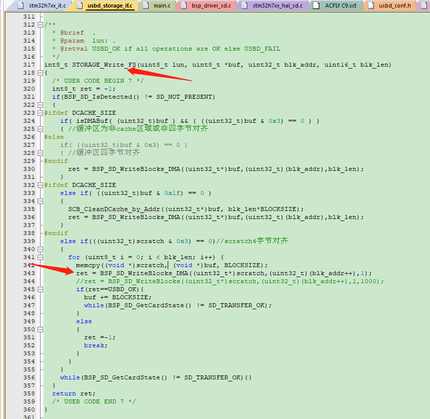

Hi,I am desperate to find a solution about the usb_device MSC sd card driver problem.I wonder if it's a bug?

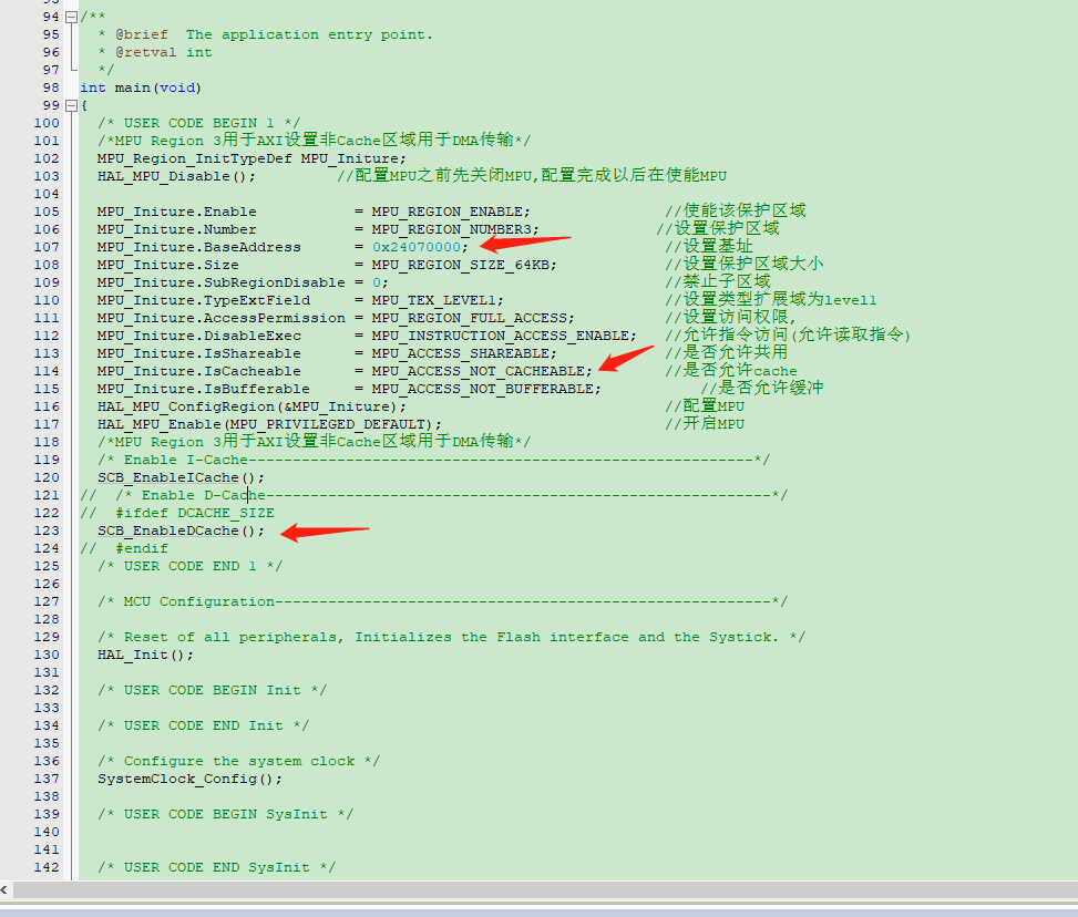

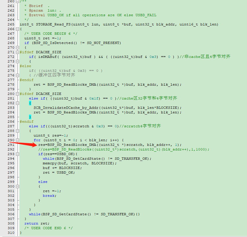

my HAL Driver Version is 1.8.0,cubemx version is 5.6.1. my MCU is stm32h743. I generate a MSC project with cubemx,in usbd_storage_if.c file,there are STORAGE_Read_FS and STORAGE_Write_FS functions,as the picture shows,

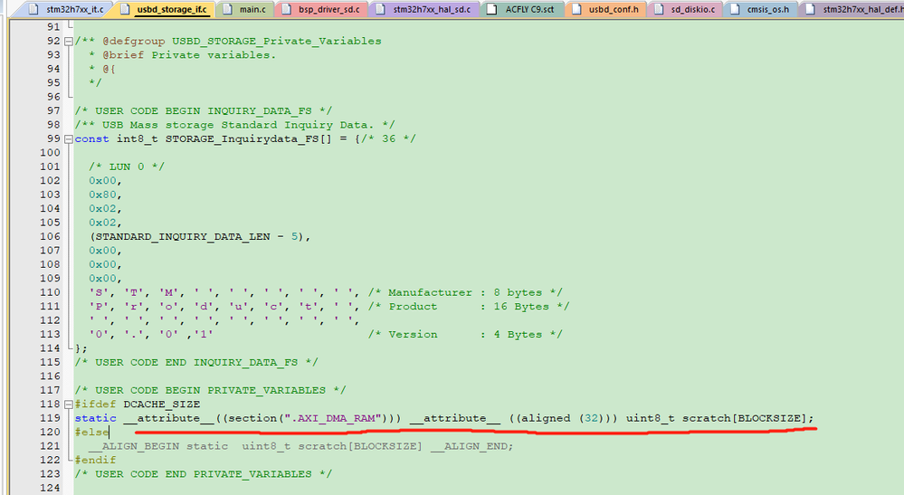

The first problem is if I use BSP_SD_WriteBlocks and BSP_SD_ReadBlocks,the project is working while using BSP_SD_WriteBlocks_DMA and BSP_SD_ReadBlocks_DMA fail,I have took aligned and cache in consideration,but it is still not working.Can not enter the SDMMC1_IRQHandler() interrupt.
The second problem is that the project is not working when open Dcache,no matter using BSP_SD_WriteBlocks or BSP_SD_ReadBlocks_DMA.
In sum,it only working when Dcache is closing and DMA is not use.
I hope you might spare your time and help me out,thanks a lot.:rainbow:

Hi @Rdazx.1​ ,
Is this a different problem than what you are reporting in https://community.st.com/s/question/0D53W00000FNYop?
In all cases, it is preferable to keep only one topic per thread.
Coming back to your issue: did you tried to apply the fix suggested by @Robertson.Jamie​  here?
-Amel
