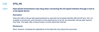

Check the OTG_HS limitation, that Host packet transmission may hang when connecting the full speed interface through a hub to a low-speed device.

Thank you @Imen.D for the response, but code fails before any transmission, just during starting initialization code.
Nevertheless, I've found the solution here:
