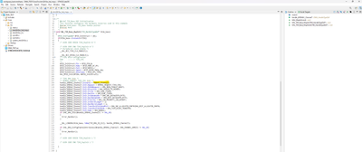

Does CubeMX skip GPDMA channel init when switching from Software to a peripheral request?
I'm using STM32CubeIDE 1.18.1v, which includes STM32CubeMX 6.14.1v, and I'm seeing unexpected behavior when working with GPDMA1 on an STM32H5 device.
When I configure a DMA channel with Request set to "Software", CubeMX generates full initialization code.
However, as soon as I change the Request to any other peripheral trigger, for example TIM2_CH1, all of the DMA configuration disappears from the generated code. Only the RCC clock enable and interrupt configuration remain.

Example 2 — Request = TIM2_CH1:
static void MX_GPDMA1_Init(void)
 /* USER CODE BEGIN GPDMA1_Init 0 */
 /* USER CODE END GPDMA1_Init 0 */
 /* Peripheral clock enable */
 __HAL_RCC_GPDMA1_CLK_ENABLE();
 /* GPDMA1 interrupt Init */
 HAL_NVIC_SetPriority(GPDMA1_Channel0_IRQn, 0, 0);
 HAL_NVIC_EnableIRQ(GPDMA1_Channel0_IRQn);
 /* USER CODE BEGIN GPDMA1_Init 1 */
 /* USER CODE END GPDMA1_Init 1 */
 /* USER CODE BEGIN GPDMA1_Init 2 */
 /* USER CODE END GPDMA1_Init 2 */
Is this expected behavior when using a peripheral request instead of Software?
Or should CubeMX generate the same kind of init code regardless of the request type?
Thanks in advance!

Hello @Tzahi14 ,
By changing the Request to [any other peripheral trigger], you find the DMA Configuration on the stm32h5xx_hal_msp.c file.
Thanks.
Mahmoud
