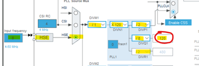

After your advice and some investigation I found out - it could be solved by using LL_RCC_SetFDCANClockSource(LL_RCC_FDCAN_CLKSOURCE_HSE) instead of LL_RCC_SetFDCANClockSource(LL_RCC_FDCAN_CLKSOURCE_PLL1Q)
Here may be a drawback: depending on HSE frequency FDCAN may be needed properly configured.
Ok Setting PLL1 properly shall work:
Just change DIV1Q from 2 to 8 or some else value s.t. PLL1Q source for FDCAN provides appropirate clock signal (in my case 120MHz)
Please refer also to this solution for more information: https://community.st.com/t5/stm32cubemx-mcus/stm32h745-fdcan-clock-frequency/td-p/83540
