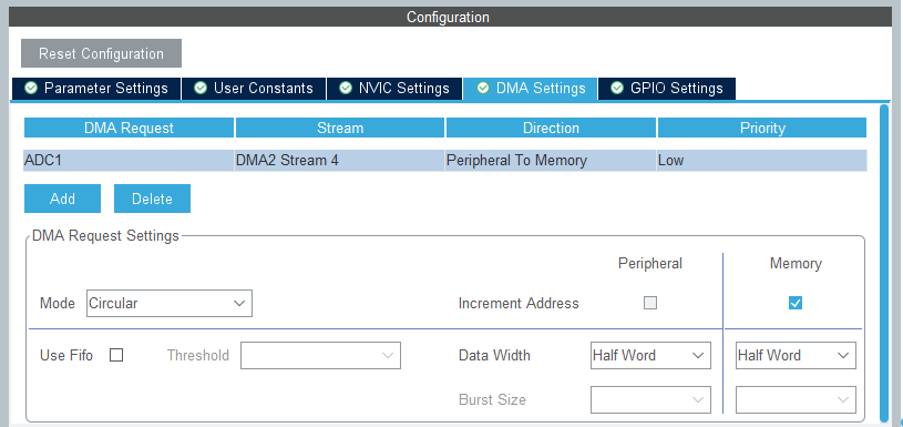

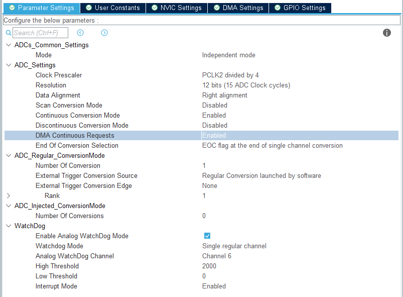

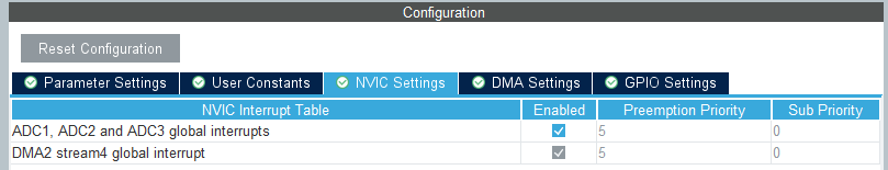

I've been trying to use the ADC of an STM32F7 so that when the level exceeds a certain threshold it start to sample the input continuously. Here is the configuration.
Then I have implemented the code as follows

But the LevelOutOfWindow callback doesn't seem to trigger,
Is there a way use both DMA and the watchdog feature?

Hello @JVALL.1​,
At the end of data transfer, in conversion complete callback, you should prevent continuous overwriting by using HAL_ADC_Stop_DMA()
You should wait until DMA stops.
You can check this post for a similar application
Best regards,
